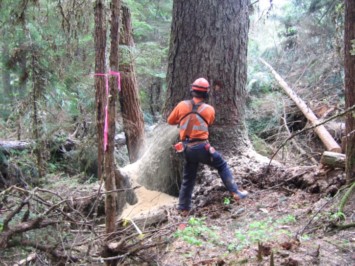

With the series on processing that I have shared in the past, I have yet to show the falling of the tree. So here ya go!
To do this job I call on a friend of mine who is a 'certified faller' and does this for a living every day!. Rememebr, this particular tree is about 48" in diametre at the butt and about 200 feet tall!!! It weighs a bit too ....

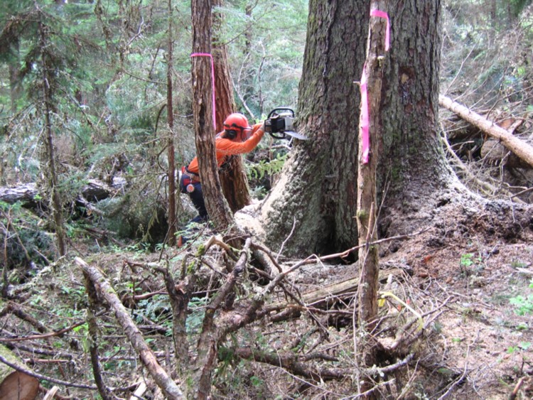

So here is Gary starting the "back cut". To fall a tree safely you need to create a "hindge". This allows a faller to leave enough wood so that the tree falls in a controlled manner. These guys can drop these giants right where they want them!

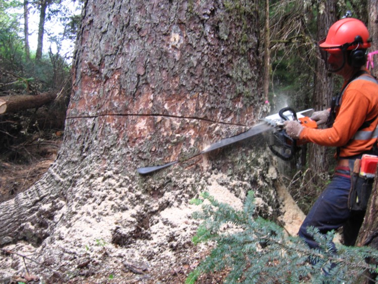

So the first cut across the front on the tree (the direction it will fall) is done, that is the first of three series of cuts.

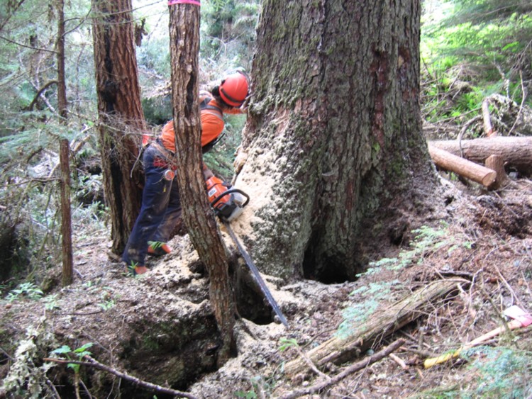

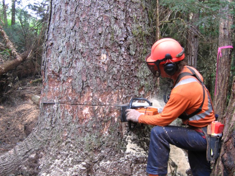

The second series of cuts creates the "undercut". Gary is starting that here.
Here he has just completed the undercut.
Now just a little "tune up" to make sure that the transition between the horizontal cut and the sloped cut is clean and crisp. This becomes the "hidge".

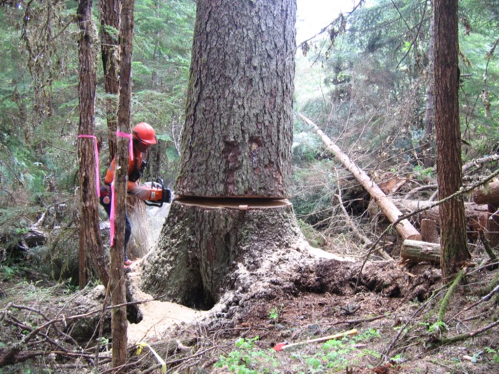

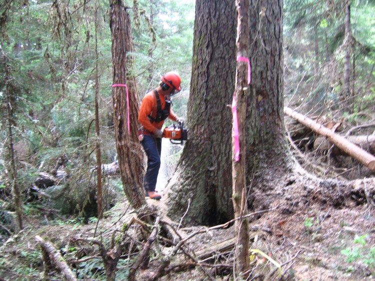

One more good look to be sure that the cuts are placed properly to get the tree down in the right place.

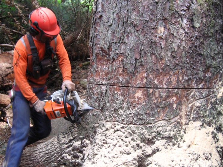

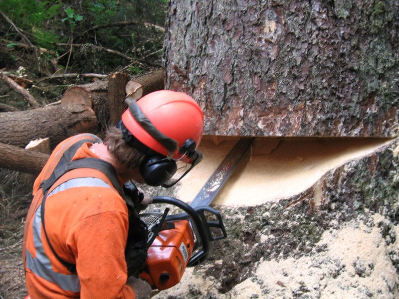

The first of a series of cuts to complete the "falling cut". This cut is horizontal and ideally is about 2" higher than the "back cut" but can never be below the back cut. This is where the "holding wood" is left that allows the faller to control the location the tree will fall. Improper falling practices, even by seasoned pros, result in many deaths each year in our forests. So Gary and I take LOTS of time getting these trees on to the ground safely.
One side of the falling cut is complete.

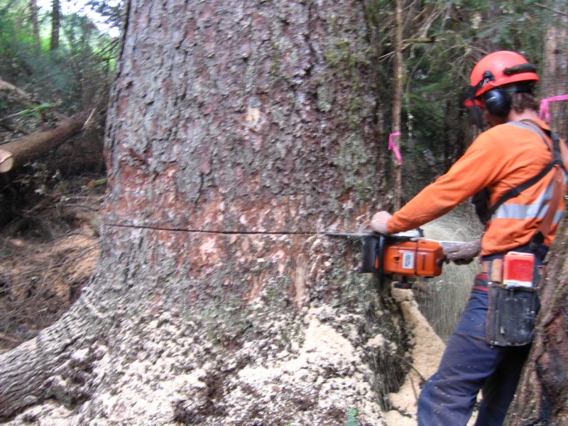

Here Gary is bringing the falling cut around the to the other side of the tree. His bar is about 3 feet long so he has to cut from both sides of the tree.

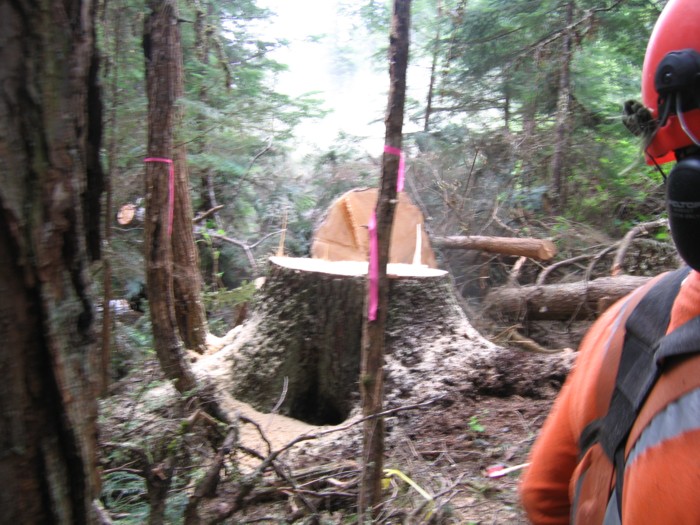

And here it is, on the ground, right where we wanted it! The main trunk of the tree is in great shape (no broken sections and no cracks!) and we did it safely!
